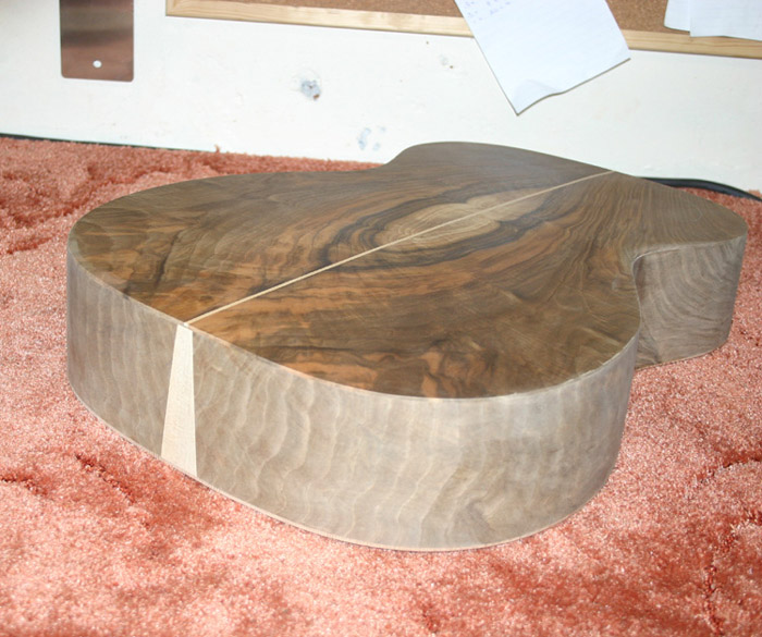

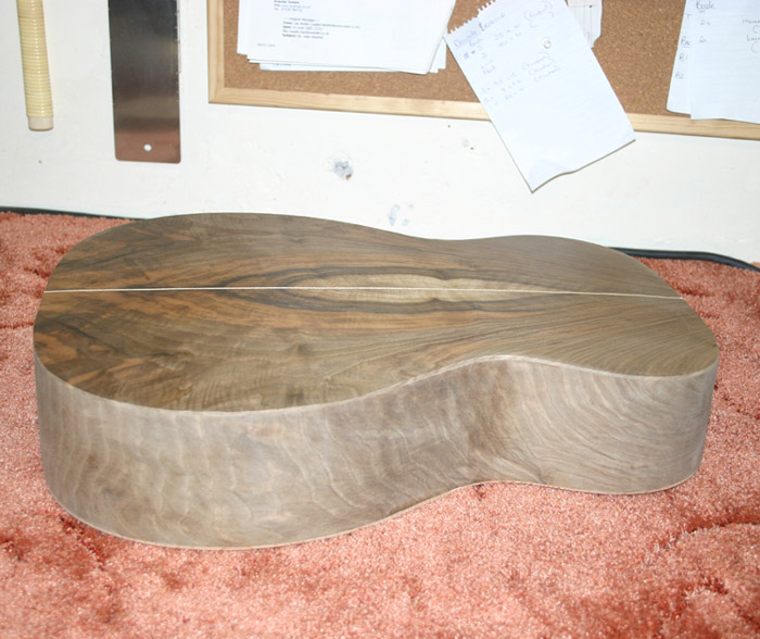

This one makes me smile every time I look at it, especially because it is for one of my favourite customers.
Thought I'd share a few pictures.
Thye difference in Colour between the Back and Sides is because the back has a wash coat on it.

Is that English Walnut??

Yes it is English Walnut (did you get yourself sorted out with some bindings ?), stuff with this sort of figure is hard to come buy as the gun makers pay silly money for it, this and a matching set came from a board that was too thin for gun stocks.

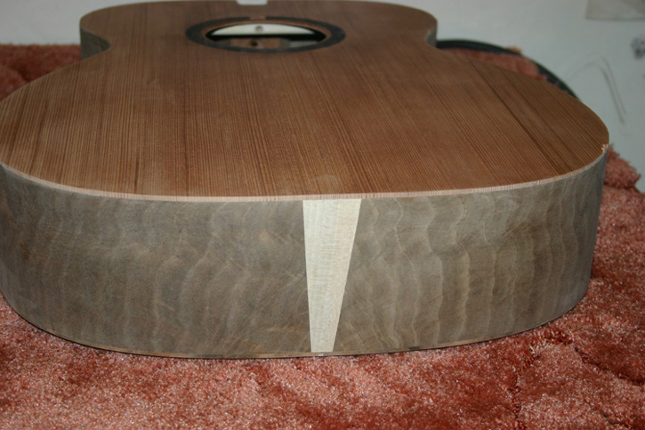

It is an OOO 24.9" Scale, it is going to be bound in just plain holly, The customer and I are going for a very plain look as the figure can do the talking.

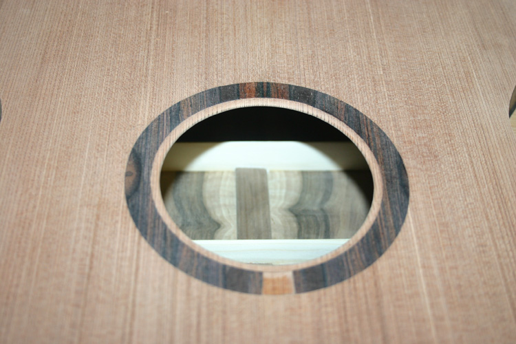

It will have an English Cherry neck, The top is Redwood, The Rossette, Fingerboard, Bridge and Headstock veneer are and will be Brazilian Rosewood, I will post some images once it is finished.

I have done alot of English Walnut, but never with the redwood before.

Russell, I can see why you're smiling! I have a similar reaction. I bet your customer is going to flip (as we say over here). Were the sides fun to bend? Looks like they might have been a challenge.

Russel, great looking box, I like the rosette, very tasteful not overblown. Remember English walnut should have a nice old looking hand rubbed patina, not too shiny.      There's a couple of sets of that waiting for me when I get back . Let me know how it sounds with the redwood, I was going to do one set with Euro and one with redwood so I'd be very interested in your opinion as I've never used redwood before.

On the Bending what I have found with walnut is it bends like a dream, but on the very figured stuff the art is to keep it as dry as possible or it starts to ripple, these one I litterally gave a single skirt along their length with a very fine mist. I also took the water off very cool at about 250 degrees and kept the heat on for longer than normal.
I'm hearing you on the finish, I will let you know on the redwood, I have done a lot with European and they sit really nice, as the English Walnut is pretty "Transparent" and in my opinion with European that is good.
